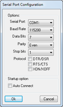

  4. If the protocol you selected requires additional configuration information, click Parameters to specify the details.
    A parameters dialog is displayed.
  5. Specify the parameters for the protocol.
