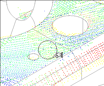

  3. In the CAD view, left-click and hold to mark the centre of the sphere, then drag the cursor to specify the radius of the sphere. For example:
  4. Release the mouse button.
    All points inside the sphere are copied to the clipboard.
