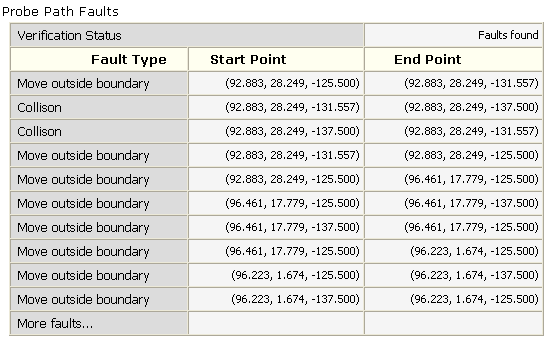

  2. Click the Info tab, and display the Probe Path Faults. The area shows:
    • the verification status of the item, such as Unverified, Unknown, Faults found, or No faults found.
    • the type of any faults, such as Bad contact, Move outside boundary or Collision.
    • the start and end locations of the moves.
    For example:
Up to ten faults can be reported for each item. If more than ten faults are found, the tab displays More faults, but does not show the details.
