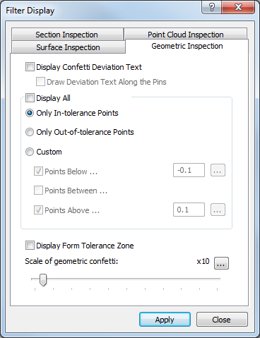

To filter the display of the measured points of geometric features in the CAD view, click View tab > View Options panel > Filter Display and select the Geometric Inspection tab.
The tab contains the following settings:
For example:
For example:
To base a display limit on the form tolerance of an item, select the item in the inspection sequence, then click . The tolerance is halved and displayed in the adjacent box.
For example:
Click Apply to save your changes and display them in the CAD view.
