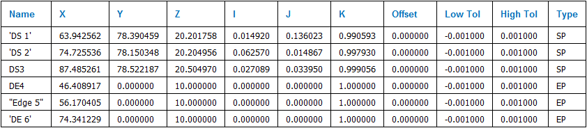

The points are exported in the following format:
- Point name: names enclosed in double quotation marks are entered by the user; names enclosed in single quotation marks are auto-generated names containing spaces.
- XYZ coordinates of the point location.
- IJK coordinates of the surface normal at the point location.
- Offset of the point from the surface.
- Low tolerance.
- High tolerance.
- Point type: SP indicates a surface point; EP indicates an edge point.
For example:
