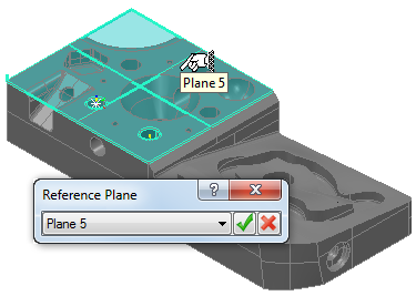

To select an item using the mouse
When you construct items, you must reference other items in the Sequence Tree. You can select an item by clicking on it in the CAD view. This is useful when you can see the item, but are not sure of its name.
  1. Click the Interactively Select button alongside the list. PowerInspect displays a dialog for the feature.
  2. Move the cursor over the item. When the name of the item is displayed, left-click to select it. PowerInspect displays the name of the item in the dialog.
    If more than one item name is displayed, cancel the selection and zoom in so you can differentiate between the items.
  3. Click to confirm the selection, or click to cancel.
