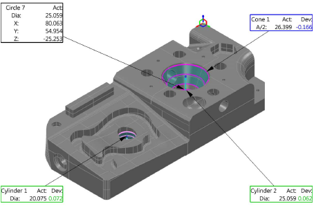

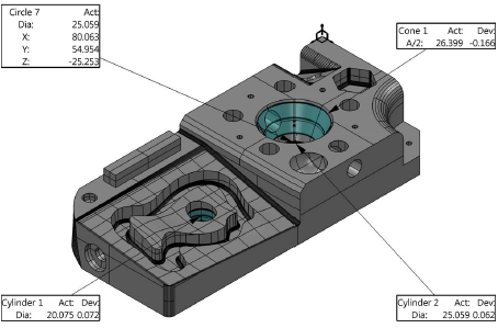

Specify the colours in which borders and text are displayed when you print the CAD View.
Ribbon: File tab
Options
Application Options
Printing
The following options for colour printing are displayed.
- Automatic — Use the target printer to determine the output colours.
- Black & white printer behaviour — Print grid lines, edges, feature boundaries, and text in black.
- Colour printer behaviour — Print grid lines, edges, feature boundaries, and text using the colours shown in the CAD view.
