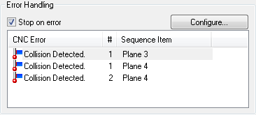

The Error handling list contains the errors identified by PowerInspect. Each entry specifies the type of error, the number of errors in the move, and the sequence item in which the error occurred. For example:
The type of error is also indicated by the icons at the left of each entry:
