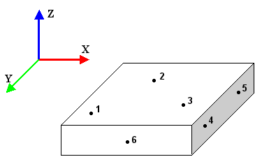

To unambiguously fix the position of a part in 3D space, you must lock its three axes of translation and three axes of rotation. The simplest method of doing this is to measure six points on three of the part's surfaces: three points to define a plane; two points to define an axis; and one point to define a position. This is called the 3-2-1 rule.
In the following example:
The order of the points specifies the direction of the line.
