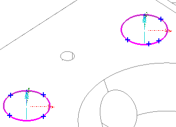

To display probe contact points
Select the Point-Cloud tab > Display panel > Geometry-Point Mode > Contact Points option to display the probe contact points for measured features.
The positions of the contact points are shown as crosses on all features displayed in the CAD view. For example:
