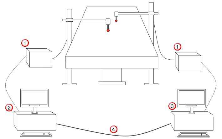

Dual-column system setup
The following example shows the setup required to run PowerInspect in dual-column mode using the I++ connection protocol:
CMM Controller
Computer running I++ Server and PowerInspect in dual-column mode. The computer must conform to the requirements specified in the PowerInspect Installation Guide.
Note: If you want to use the arms as independent measuring devices, you must also install PowerInspect on this computer.
Network connection
