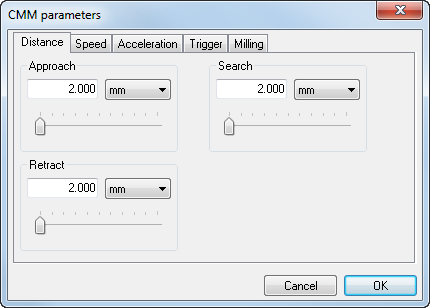

To view and set parameters for CNC machines
View and update the current parameters of a CNC machine when the document is connected to it.
  1. Attach the document to the measuring device.
  2. In the Machine tab, click Parameters.
  3. Click . The CMM Parameters dialog displays the current settings of the measuring device.
  4. Select the tabs to view the settings. Position the mouse cursor over the boxes for more information on a setting.
    Note: The parameters displayed in the dialog are specific to the measuring device being used.
  5. Click OK to save any changes and close the dialog.
    The measuring device uses the specified values when the inspection sequence is played unless they are changed by the settings of a Probe and Parameters item.
