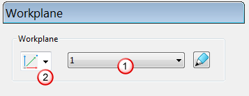

To specify the workplane of a setup
The workplane associated with a setup is used for the setup's stock, and is automatically applied to toolpaths newly created in the setup. When a setup is activated, the setup's workplane is activated.
  1. Activate the setup.
  2. Click Setup tab > Edit panel > Settings.
  3. On the Setup dialog, select Workplane from the list view to display the Workplane page.
  4. On the Workplane page, choose a workplane from the list .
  5. If your project has no workplanes, choose an option from the workplane creation list to create a workplane of the selected type.
  6. If you want to edit the selected workplane, click to display the Workplane Editor tab.
