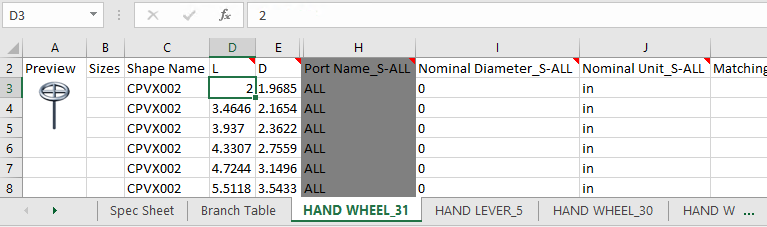

Edit exported spec data
  1. Open the exported Excel file.
  2. Go to the tab of the part you want to edit.
  3. Edit the content you want to change.
    Note: Some fields are write-protected so they should not be edited.
  4. Save the file.
