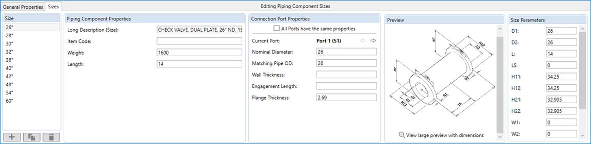

Catalog Editor - Sizes Tab
Sets component size properties.
Size
Displays sizes for the component.
Add Size
Adds a new size to the list. The new size is listed as undefined in the size list. You can specify the Nominal Diameter after adding to set the size.
Duplicate Size
Copies the properties and dimensions of the size selected in the Size list. The new size is listed as undefined until it is assigned a unique Nominal Diameter.
Remove Size
Removes a size from the list.
Piping Component Properties
Sets properties that are unique to a specific size.
Connection Port Properties
Sets values that define how the part connects to pipe or pipe components.
Size Parameters
Displays the component dimensions. These values are not automatically linked to port properties.
Hold the mouse over a size box to display important information about the parameter value. Some parameters allow you to enter special values such as zero to specify a default or flag to draw a collar.
