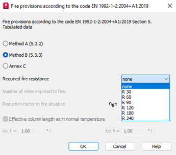

Calculation Options command or
Fire provisions
The calculations in this section are performed in accordance with EN 1992-1-1:2004/A1:2014/NA:2016, paragraph 5: Tabulated data and Annex C of this code.
To assess fire resistance, one of the three methods described in the standard can be utilized:
