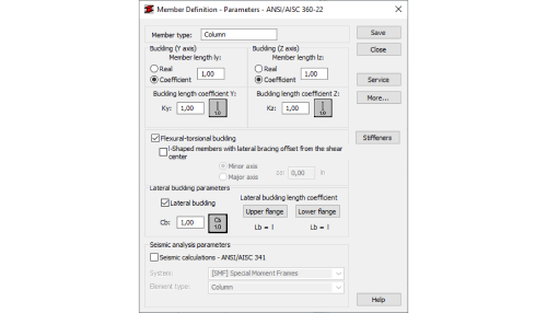

Steel member design according to ANSI/AISC 360-22 standard
The following updates have been introduced:
- calculation formulas
- seismic calculations
- required databases
- user interface following the code updates
The code is set as default in the relevant regional settings.
