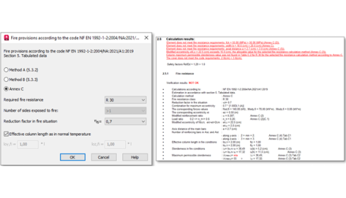

Robot Structural Analysis Professional 2025 includes EN 1992-1-2:2004/A1:2019 and NF EN 1992-1-2/NA/A1 March 2021 for structural fire column design.
It also offers improvements to Reinforced Concrete design listed in the release notes document.
The code is set as default in the relevant regional settings.
To find this new Reinforced Concrete design code:
Fire Provisions.
