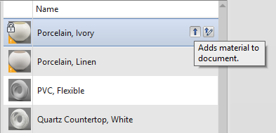

To add a material to the current project, first find the material in an existing library, then use one of these methods:
To copy a material to a library, use one of these methods:
If you copy a material to a library where another material of the same name exists, you are prompted either to overwrite the version in the target location, or to keep both. If you keep both, the material name of the material you are copying is appended with a number; for example, Porcelain, Ivory(2).
