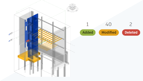

After logging into your Autodesk Account, in a Revit project containing a
linked coordination model click Collaborate Coordinate tab
Coordination Model Changes button to open the Coordination Model Changes palette.
The palette displays an overview of the added, modified or deleted objects, which are highlighted on the model too. You can filter the categories to only show added, modified or deleted objects by de-selecting the categories that you do not want to display.
