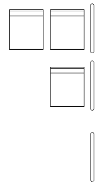

Example of a parametric family array flexed to 2 in project, then 1 and 0:
