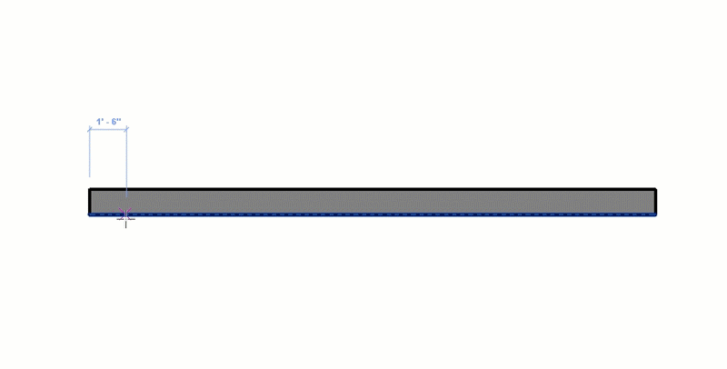

You can automatically join a newly created architectural wall with the adjacent wall, or join and lock them together to speed up your modeling process when working with multiple walls.
In the Modify | Place Wall tab, Placement panel, click
(Auto Join) to only join the new wall with the adjacent one, or
(Auto Join & Lock) to join the walls and lock them to move together. Any inserted elements in the joined walls will perforate both walls .
