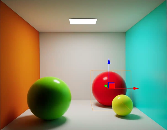

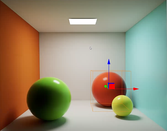

  • Rendering Color Space - Switch between different rendering color spaces and choose from the following:
    • Linear Rec.709 (sRGB) - The standard for high definition television. Before version 2025.2, this was the only available rendering color space in VRED. Now, it is exposed and is used as the default color space.
    • ACEScg - The standard working space for CGI rendering and composition. ACES was developed by the Academy of Motion Picture Arts and Sciences. ACEScg is the version of the ACES encoding system for computer graphics, widely adopted in the industry. It has become the industry standard, because compared to sRGB, ACEScg uses ACES AP1 wide-gamut primaries and works with a lot more color information.
    • Linear P3-D65 - The colorspace developed for digital cinema with an adjustment to D65 white point. P3-D65 is a wide gamut display-referred color space, used primarily for projection. It is a variation on DCI-P3, using the same primaries and electro-optical transfer function, but with the D65 white point used by video.
    • Linear Rec.2020 - The standard for ultra high definition television. Rec. 2020 is designed to work with high dynamic range content. Similar to ACEScg, it covers a significantly large color space (around 75.8%) of all visible colors, but compared to ACEScg, all colors covered in Linear Rec.2020 are within the visible spectrum. To specify your preferred Rendering Color Space, use the Preferences > Rendering > Render Settings > General Settings > Features > Rendering Color Space option.
      Linear Rec.709 (sRGB) ACEScg
      2025.1 2025.2
      In the Color Picker, use the L, a, and b values to display colors that are extremely saturated and outside the sRGB color space, as these values below zero. Note that to see them, you will need a display with a wide color gamut.
      New L, a, and b color space values
