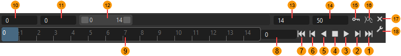

For information on using the Timeline, see the following:
Sets the slider to the end frame.
Sets the slider to the next keyframe. A keyframe represents a saved state of attributes at a specific time. Keyframes are the basis for non-linear animations in VRED.
Plays the animation.
Stops the animation.
Plays the animation backwards.
Moves the slider to the previous keyframe.
Moves the slider to the starting frame.
Displays the current frame number. Click it to enter a frame number.
Visually represents of the animation frames.
Sets the starting frame of the full timeline range.
Sets the starting frame of a specific playback range.
Sets a specific playback range.
Sets the end value for a specific playback range.
Sets the end frame of the full timeline range.
Sets a keyframe for the selected object and all its animated attributes. This has the same effect as Key All Channels in the Curve Editor.
Toggles activation of the local evaluation of the shown curves in the Curve Editor, instead of all active animation in the scene.
Closes the Timeline.
Opens the Animation Settings dialog with base, playback, and timeline settings. It also providing access to the Animation preferences.
