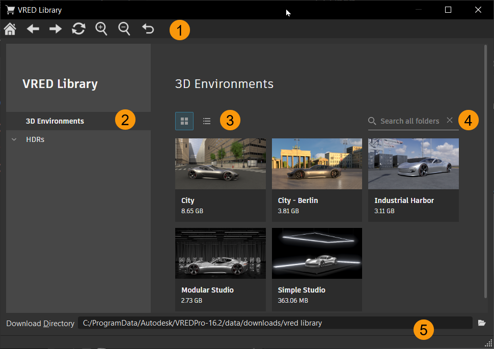

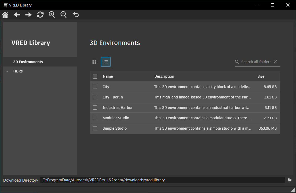

Labelled VRED Library
Since the toolbar and Download Directory are common to all web shops, see About Web Shops for these.
1 QuickAccess Bar
Use these when working in the VRED Library.
Home icon - Displays the VRED Library homepage.
Back icon Forward icon - Displays to be previous or following page.
Refresh icon - Refreshes the list to ensure the latest files are loaded for use.
Zoom In icon Zoom Out icon - Enlarges or reduces the size of the displayed library content.
Reset View icon - Resets the view after Zoom In icon (Zoom In) or Zoom Out icon (Zoom Out) has been used.
2 Tree
The tree contains downloaded files that are grouped into 3D Environments and HDRs. Click a category to load its files into the section to the right. Use the Tile and List buttons to change the view and Search to locate a file.

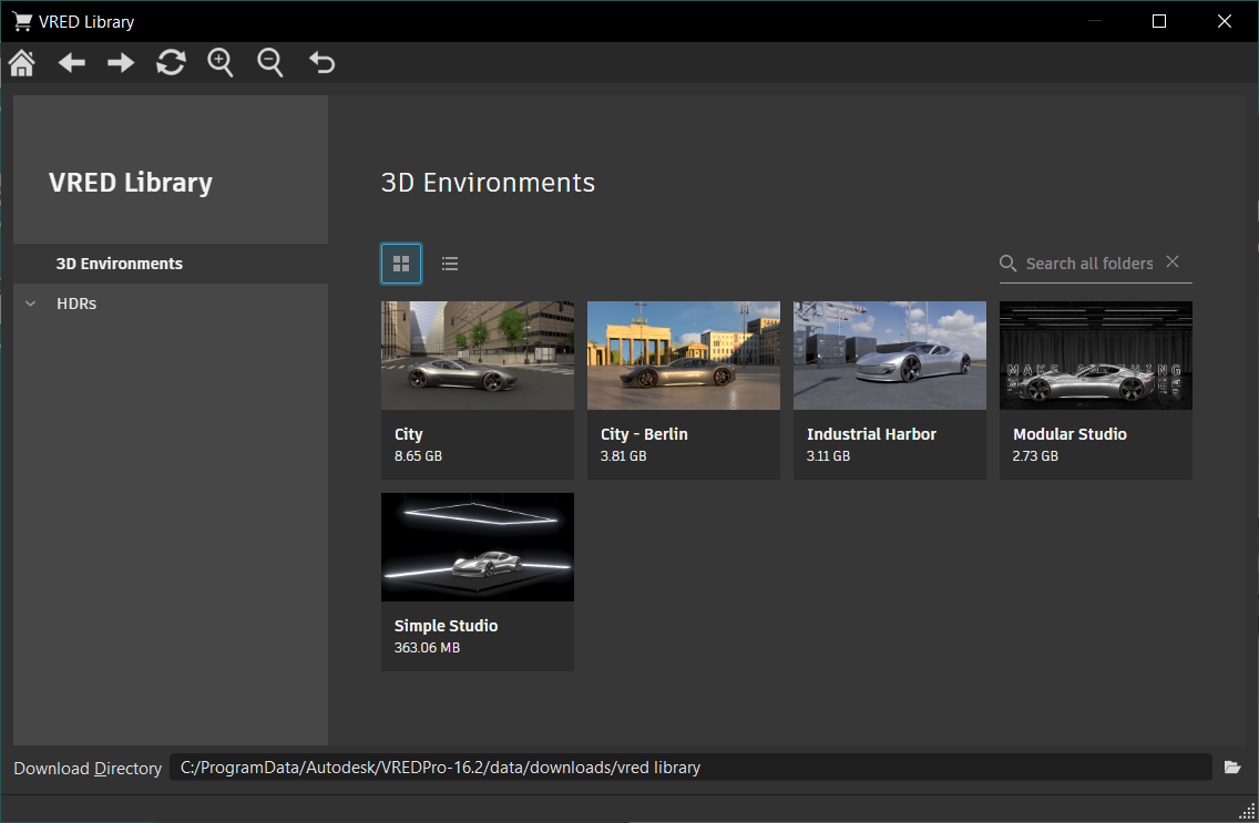

3D Environments
These 3D environments are fully immersive and not limited to an image projection of a sphere or dome. This leads to a more realistic experience when moving through the environment. This also means there is no image distortion of the HDRs and no backplates needed.
All 3D environments are optimized for real-time use cases in OpenGL, such as VR sessions, as well as offline renderings/high-end visualization in raytracing. They can be viewed in both render modes and are fully modeled in 3D with actual geometry.
The VRED Library allows us to provide and update our content independent of the VRED release cycle. That means you don't have to reinstall many, potentially very large files when you update or reinstall VRED. Instead, you can selectively download assets as you need them.

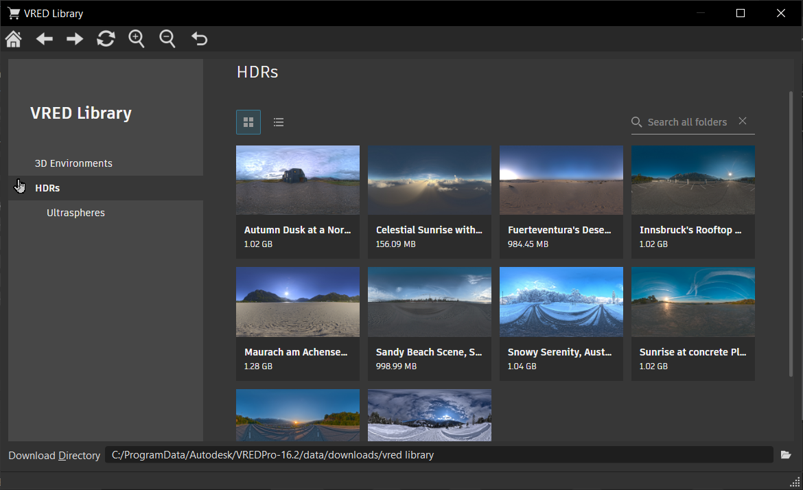

HDRs
Find 10 free Ultrasound HDRs in this section. Click the heading to expand it and expose your list.

3 Tile and List View
Use these two options for changing the view.
For information on downloading files, see the following:

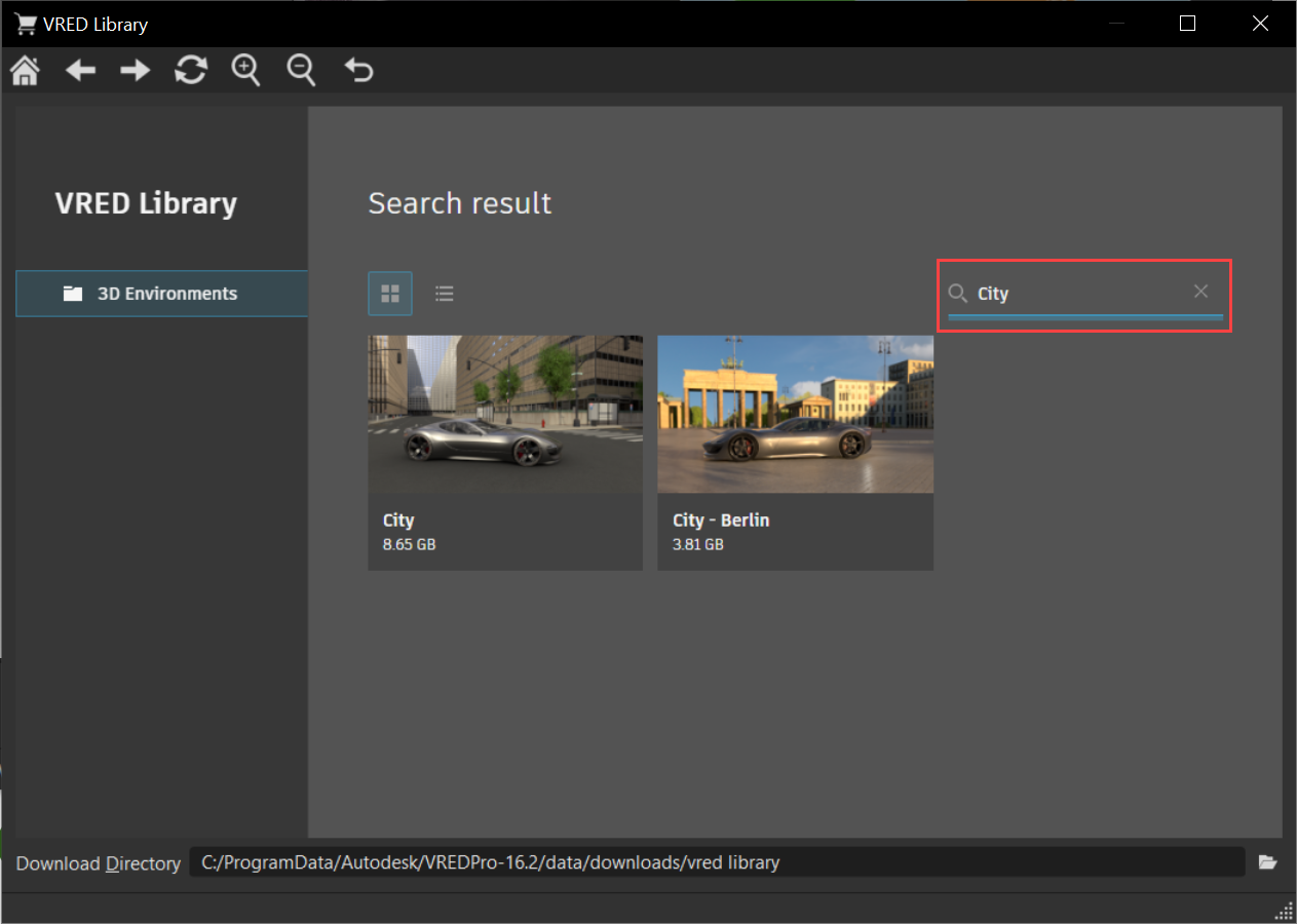

In the Search field, once there are two characters, VRED starts to generate a list of search results, with matching results appearing below
Library Search
  1. Enter a string in the Search field.
  2. Click one of the results to display a summary about the file, link to the file, and file size.
  3. Click the file link to download it to the location set in Download Directory.

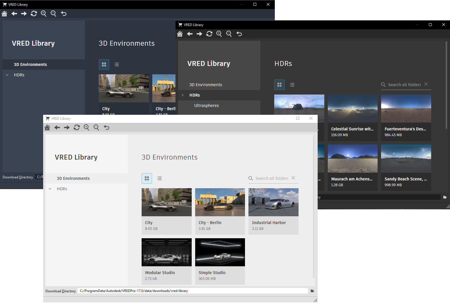

Color Theme
When you change the color theme used by VRED, it is also applied to the VRED Library.

5 Download Directory
See where your content is being stored. Change the location by clicking Browse icon and entering a new location.
