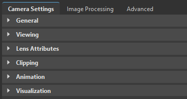

Scene > Camera Editor > Camera Settings
Use these parameters to modify the camera's settings.
General
Provides the following general options:
