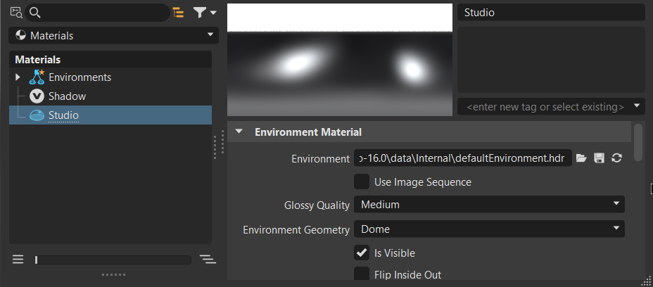

Environment Material
Environment - Loads the HDR image to be used as the lightsource. The HDR image is used as an environment, which is reflected on reflective surfaces in OpenGL rendering. In raytraced rendering, the 3D space is reflected in the surfaces. LDR (.png and .jpg) can also be loaded.
Click
to locate and assign a texture. When a texture is assigned, the path and filename are displayed in the field to the left.
Use Image Sequence - Select when an image sequence is loaded in the Use Texture box. This uses an image sequence as a texture. The image name for the sequence will be generated based on the filename and the image number. Use the Curve Editor to animate the image number. Go to Animation > Timeline. Click play to view the animated image sequence on the material.
For a group of images to be considered an image sequence, there must be at least two images with the same name with an increasing numeric value. The required naming format is name, number, and extension. For example, image000.png image01.png.
Glossy Quality - Defines the quality for the precomputed glossy IBL. Also, use it for the precomputed raytracing mode. This is not for Full Global Illumination. The entries are internally specifying a sample amount per pixel and correspond to custom or the following values:
Low - 256 samples
Medium - 512 samples
High - 1024 samples
Ultra High - 2048 samples
Higher values generate better the visual quality. Lower values are computed faster.

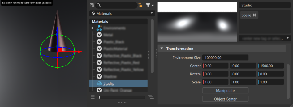

Transformation
The source of spherical projection of the Sphere Environment material can be set with transformation parameters.
Manipulate - Activates/Deactivates the interactive environment texture manipulator in the render window. This function requires a selection in the Scenegraph and a single selection in the Material Editor. Use it to rotate, scale, and translate your environment material.
