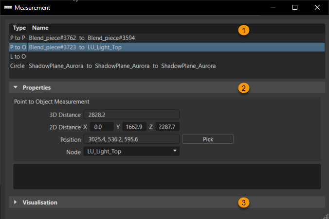

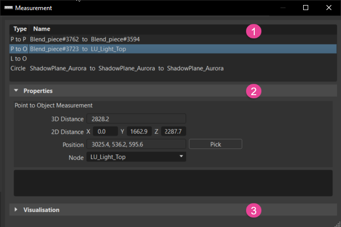

The Measurement module has three sections. The Measurement List View displays the type of measurement and name for that measurement. Properties contains properties for the selected measurement. Visualization contains some general options, which affect all measurements, such as the active color scheme or hiding all measurements in the Render Window.
  Properties
Shows different properties, depending on the selected measurement.
Point to Point - Contains the following options:
- 3D Distance - Shows the distance between two points.
- 2D Distance - Shows the distance between the two points for each axis.
- First position - Shows the coordinates of the first selected position. You can select a new position using the Pick button.
- Second position - Shows the coordinates of the second selected position. You can select a new position using the Pick button.

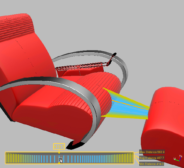

Line to Object - Contains the following options:
- Line - Shows the selected line.
- Object - Shows the selected node.
- Avg. Dist. - Calculates the average distance.
- Min. Dist. - Shows the minimum distance.
- Max. Dist. - Shows the maximum distance.

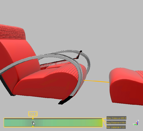

Gap - Contains the following options:
- First Object - Shows the first selected node.
- Second Object - Shows the second selected node.
