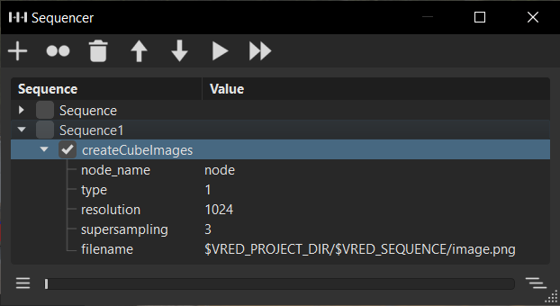

Sequencer icon Sequencer
Interaction > Sequencer
Use the Sequencer to set up command sequences and execute them as a batch process from top to bottom. You can initiate execution or set up other actions in the application. All entries are case-sensitive.
The Sequencer contains a List View that lists all sequences and values associated with them. It also contains a timeline and an QuickActions Bar at the bottom.
Sequencer
Context Menu
  • Create Sequence - Creates a sequence in which actions can be queued.
  • Create Action - Actions are function sets, which can be used to activate and edit settings in VRED.
  • Duplicate - Duplicates the selected sequence or action.
  • Select All - Selects all sequences and actions.
  • Rename - Renames the selected sequence or sets the selected action parameter value. Actions cannot be renamed, but you can enter a comment for each action.
  • Delete - Deletes the selected sequence or action.
  • Active - Toggles the active state of the selected sequences and actions. Activated actions and sequences can be executed.
  • Move Up - Shifts the selected sequences or actions one step up in the process queue.
  • Move Down - Shifts the selected sequences or actions one step down in the process queue.
  • Run - Executes selected sequences and actions. Inactive actions are not executed.
  • Run All - Executes all sequences that have an active state.
Slider
Use the slider at the bottom of the module to expand or collapse all sequences and actions at once.

  • createCubeImages - Exports an environment image.
    • node_name - The name of the node that is used for the camera position is specified.
    • type - Defines the type as which the cube image is created. Images are rendered and processed based on the chosen type:
      • 0 separate images
      • 1 vertical cross
      • 2 horizontal cross
      • 3 spherical map
    • resolution - Sets the quadratic resolution in pixels.
    • supersampling - Defines the level of anti-aliasing.
    • filename - Filename of the images.

  • Button QuickActions Bar - QuickActions Bar at the bottom of the module allows easy access to commonly used commands:
    • Create - Creates a sequence.
    • Duplicate - Duplicates the currently selected sequence or action.
    • Delete - Deletes the currently selected sequence or action.
    • Move Up - Shifts the currently selected sequence or action one step up in the process queue.
    • Move Down - Shifts the currently selected sequence or action one step down in the process queue.
    • Run - Executes the currently selected sequences and actions.
    • Run All - Executes all sequences that are checked have an active state.
