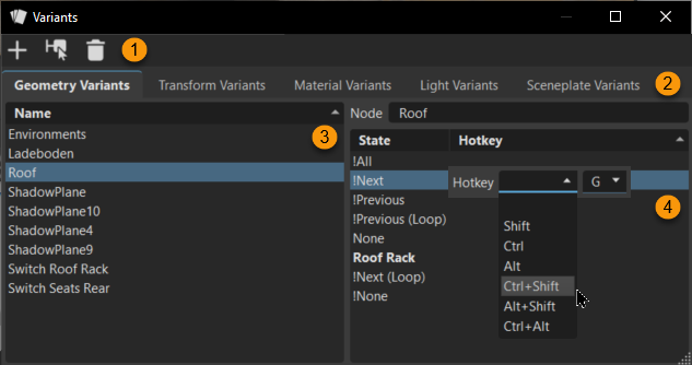

Variants module
1 QuickActions Bar
The QuickActions Bar contains visual shortcuts for commonly used commands in the Variants module.
Create Create - Automatically creates new variants of the current type.
Select Node Select Node - Selects the node in the Scenegraph related to the selected variant.
Delete Delete - Deletes the currently selected variant.
2 Tabs
The tabs under the QuickActions Bar and span the width of the window. Each tab contains all the variants of that type, such as geometry variants in the Geometry Variants, on the left and the node name, state, and assigned hotkeys on the right. Information about each tab is listed below.

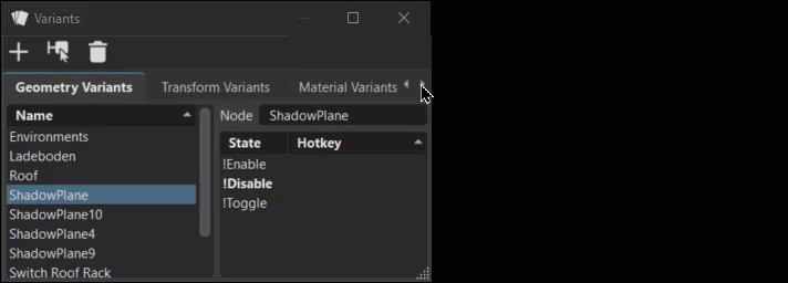

Troubleshooting: I Only See a Few Tabs
Depending on the size of the window, not all the variant tabs may be visible. To access other tabs, either expand the Variants module or click the arrows along the top.
Variants Module
3 Variant List
The left side of the Variant module lists all variants for the selected tab. To reverse the order of the list, click the Name title bar. To modify a variant, show or hide content, or select nodes, use one of two context menus.
Context Menu
Selecting a variant or clicking an empty area and right-clicking accesses options for creating all, renaming, deleting, clearing, showing and hiding content in the render view, showing connected vsets, selecting switch nodes, and selecting nodes. The tab selected also determines the available options.
4 Node View
The right side of the Variant module provides tools for setting the state and hotkey for the variant selected in the Variant List to the left.
Node
The name of the selected variant nodes appears in the Node field.
  • To rename the node, click this field.
  • To edit or select the node name, right-click to access different options.

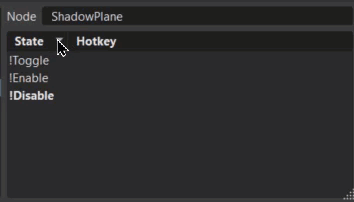

States
The States section displays all states that are available for use and is used for assigning a state to the node.
  • Click the States title bar to reorder the list of states and their assigned hotkeys.
  • Right-click a state to access a context menu for selecting, refreshing, and setting the default state. When a state is set as the default, the state is highlighted.

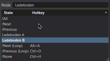

Hotkey
The Hotkey section displays the hotkeys assigned to different states and provide an interface for creating them. Use hotkeys to quickly access variants.
  • Click the Hotkey title bar to reorder the list of hotkeys and their assigned states.
  • Click the hotkey area next to a state to access the hotkey inerface.
    Variants hotkey interface

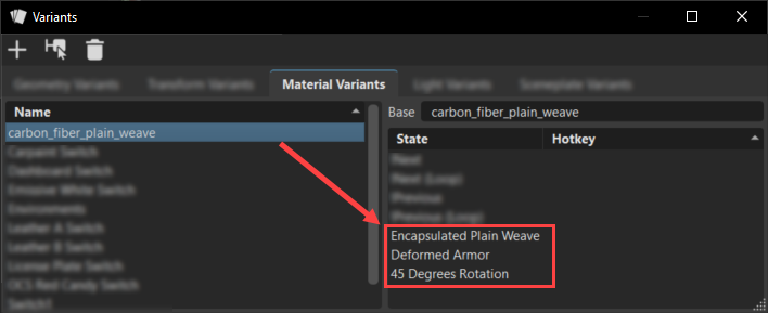

Material Variants
Allows objects to have multiple materials assigned, such as switches, environments, OCS, Substance, and X-Rite. Substance preset and sub materials are listed. You can switch between the states quickly.
Substance in Variants module
