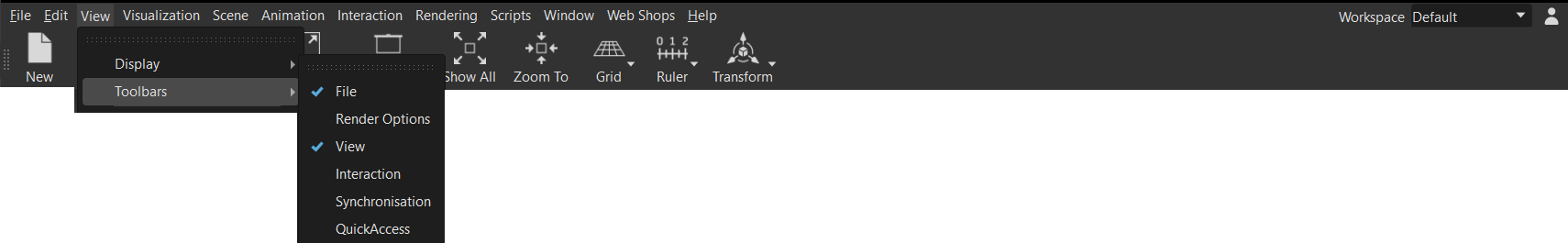

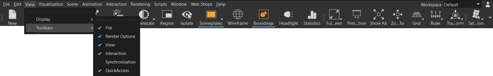

How to Show or Hide Toolbars
Select which toolbars are visible in the main VRED window. Show or hide tools.
In the Menu Bar, select View > Toolbars, then select one or more options.
  • When checked, the tools in that toolbar appear in the main VRED toolbar.
    Show Hide Toolbars menu
  • When unchecked, the tools in that toolbar will be removed from the main VRED toolbar.
    hide

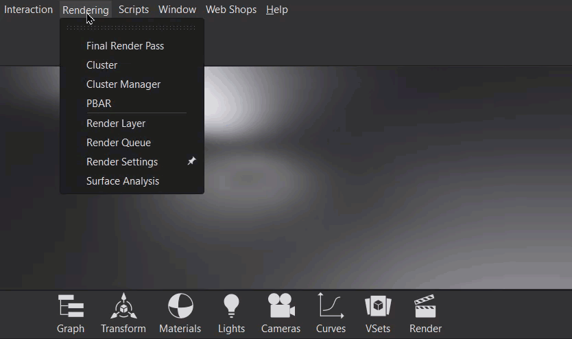

How to Pin a Module to the Quick Access Bar
Within a menu, as you scroll down its options, if a module is listed and can be pinned, a pin will appear to the right as the option is active. Click the pin to pin the module to the Quick Access Bar. Do this instead of going through the module's Windows menu bar. Already pinned modules will have a highlighted pin next to the option name.
Showing the pinning workflow
To remove a module from the Quick Access Bar, either unpin it in the menu, or do this.

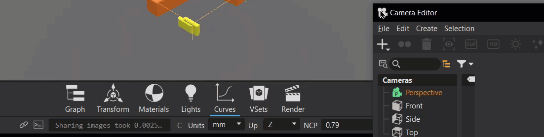

How to Add and Remove a Module from the Quick Access Bar
Remove Quick Access toolbar modules
  1. To add a module, click the icon in the top left corner of any module.
  2. Select Add to Quick Access Bar. This adds it to the far right of the bar.
  3. To remove a module, click-hold the module from the Quick Access Bar and drag it over the Remove button that appears.

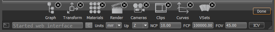

How to Delete a Tool from the Quick Access Bar
  1. Double-click and hold a tool in the Quick Access bar, to access the Delete icon.
  2. To delete a tool, click the Delete icon belonging to that tool.
  3. When finished, tap Done.
    Delete Quick Access toolbar tools

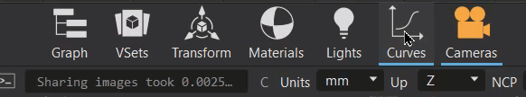

How to Reorder Tools in the Quick Access Bar
Rearranging icons
  1. Click-hold until the toolbar changes to its edit mode.
  2. Click-drag a tool icon to any place in the toolbar.
  3. Click the Done button to exit the edit mode.

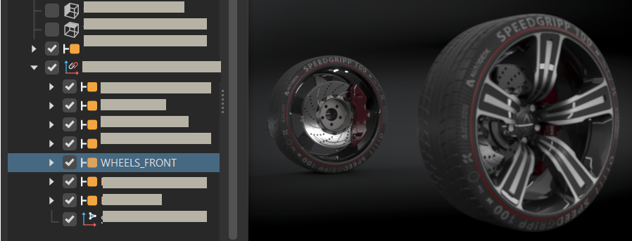

How to Show or Hide Selected Content
To show or hide everything that is currently selected, in the Menu Bar, select Visualization > Isolate View Selected. This adds an Isolate View (name of the selected node) label to the Viewport. Visibility of environments and backplates is not affected. In previous versions of VRED, this feature was available by dragging a node from the Scenegraph into the Viewport.
Show Simulation Isolate
