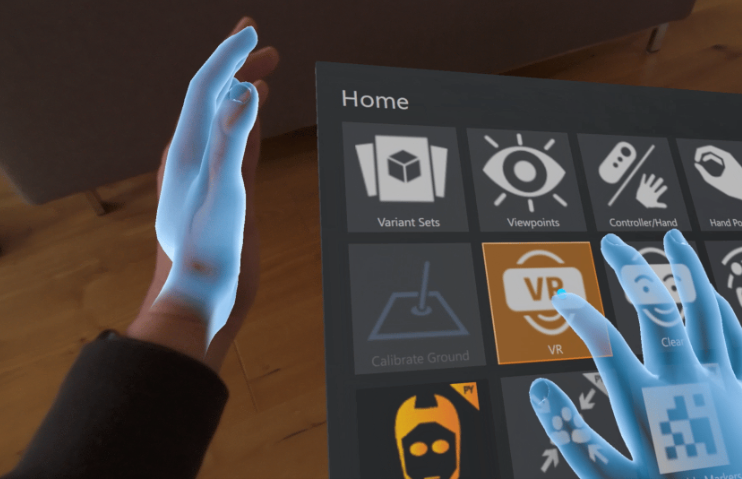

Tip:
If you find it hard to use the VR Menu, try disabling Hand Depth Estimation. This enables tracked hands to be displayed over your real hands to help with VR Menu selection. To set this as the default behavior in MR, go to Preferences > Extended Reality > Interaction > Hand Tracking, and enable Show Tracked Hands in MR.
