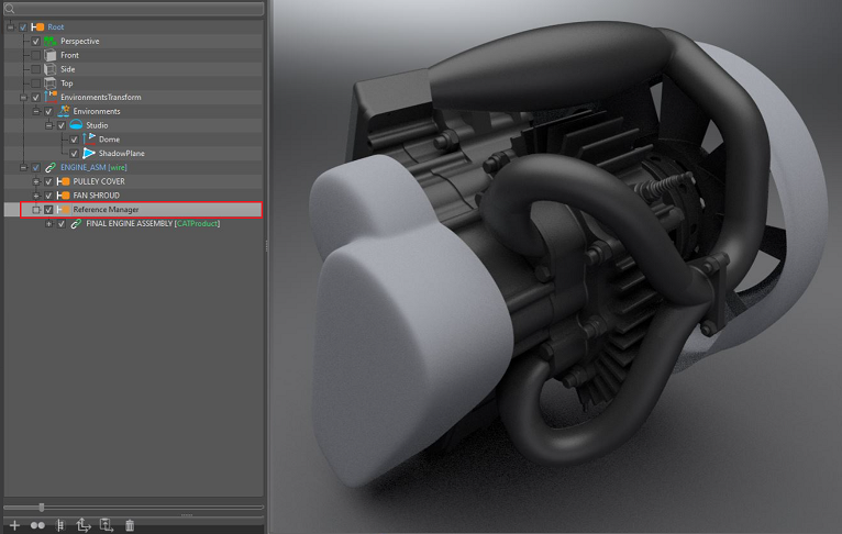

For VRED 2022 and beyond, import native CAD files assembled in the Alias Reference Manager into VRED. A new Reference Manager group will be created in the Scenegraph to mimic the Alias Reference Manager and layers.
Alias 2021 introduced the possibility to create an assembly structure from various CAD file formats, such as .wire, .iges, .step, etc. Alias creates an intermediate .wref reference file for modeling and visualization purposes in the viewport, while keeping the link to the original CAD file in the background. When importing an Alias .wire file containing an assembly structure into VRED, the linked CAD files are now imported, as well. Find these imported assembled files under the new Reference Manager group in the Scenegraph.

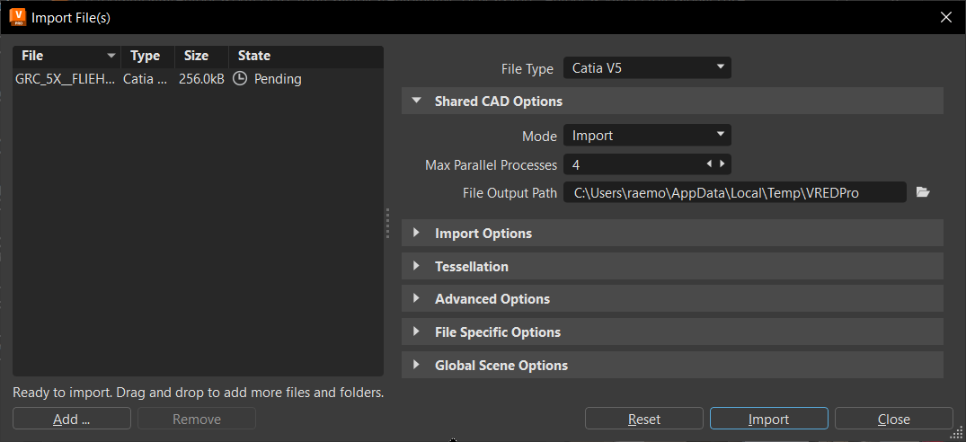

  3. In the Import File(s) dialog, set file specific options, such as Import Sub-Referenced Files or Reference Behavior.
  4. Click Import.

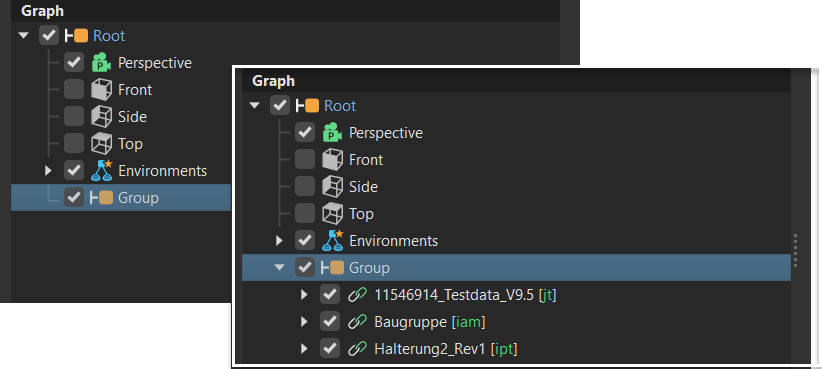

    The file or files are added to the Scenegraph as child nodes of the selected node.
    Select Node Child Tree View

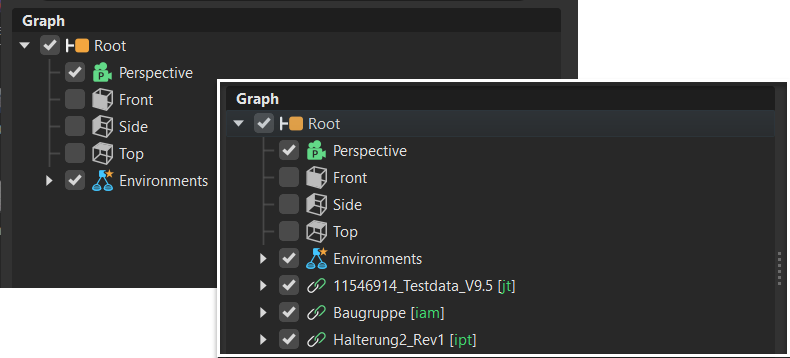

    If no node was selected in the Scenegraph, the objects are added as children of the root node.
    Add File Tree View

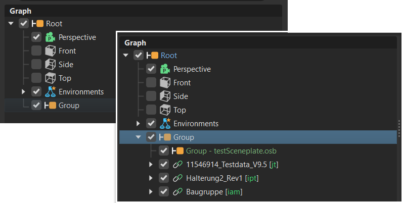

    All objects of an added file are grouped in a group node. Imported files are marked green in the Scenegraph.
    Add File Group Child Tree View
