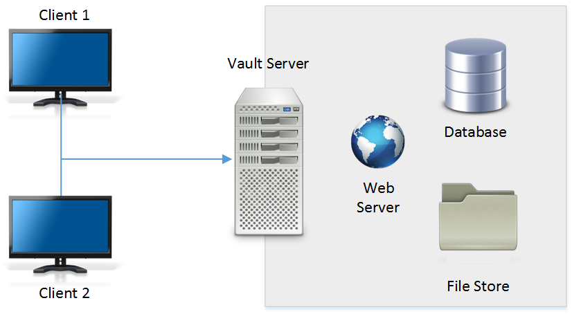

Three primary components make up the Vault server: a web server, a database, and a file store. The following figure illustrates the basic configuration of the components.
![](https://help.autodesk.com/cloudhelp/2025/ENU/Vault-About/images/GUID-3B186A85-CCD8-41C2-B518-817C279B9054.png)
Database Server
The database server tracks all the relationships between data. It acts like a library card catalog, containing indexes and pointers of where to find related information.
By default, the Autodesk data management server installs Microsoft® SQL Server Express. Microsoft SQL Server Express can be upgraded any time after the Autodesk Data Management Server components are installed.
See Vault Requirements and Upgrade Autodesk Vault for more information.
File Store
The file store and the database server work with each other. The database provides the index information for the location of files. The file store is the secure location on the server where the files are located.
Web Server
Autodesk Data Management Server requires that Windows Internet Information Services (IIS) is installed.
The Autodesk Vault server is actually a Web application that uses services to manage the communication between the clients and the server with Web services. The interaction between the clients and the server resembles the way a web browser communicates with a site on the Internet. The Web services use standard HTTP methods, communicating over the Web server port 80 by default. Microsoft IIS is required for multiple-user configurations.

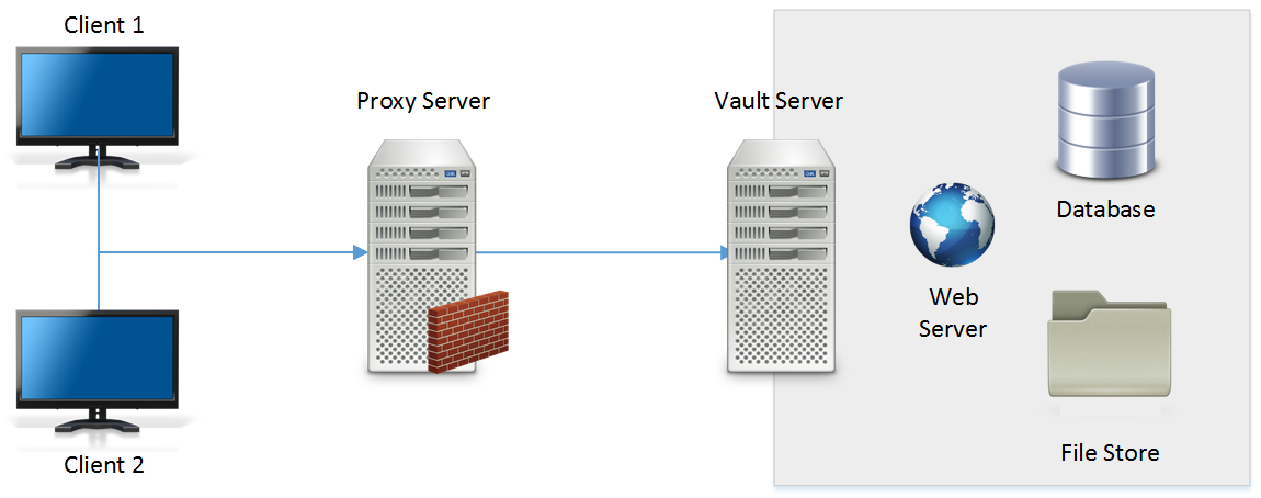

Proxy Server
A proxy server forwards requests of client computers to other servers. Some networks force all client computers to use a proxy server for all web service requests.
![](https://help.autodesk.com/cloudhelp/2025/ENU/Vault-About/images/GUID-996BDB08-883B-46E7-8A86-F4967D516DA1.png)
If your network uses a proxy server, you can configure it to use a host name or bypass the proxy server of your host clients.
