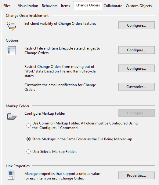

Configure change order behavior on the Change Orders tab of the Vault Settings dialog.
** Access the Change Orders Tab on the Vault Settings Dialog **
The Change Orders tab contains options for restricting item changes to change orders depending on lifecycle or state, configuring the markup folder, managing change order link properties, and defining change order numbering schemes. You can also disable the Change Orders feature.
Disable or enable the Change Orders feature to better control user access.
Restrict File and Item Lifecycle state changes to Change Orders – Click Configure to specify whether lifecycle state changes are driven only by change orders.
Restrict Change Orders from moving out of Work state based on File and Item Lifecycle states – Click Configure to select which lifecycle states prevent a change-order from moving out of a work state.
Customize the email notification for Change Orders - Click Customize to specify the email notification template.
Linked user-defined change order properties are defined and managed in the User Defined Linked Properties (Change Order) dialog box.
The numbering scheme used for identifying change orders can be customized.
