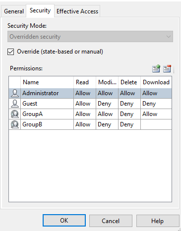

Access Control Lists (ACLs)
The Access Control List lets you add and remove members to control who has access to certain files, folders, items, and custom objects. You can also control whether the member can only view the content, modify the content, and delete the content.
Note: Items and custom objects are available in Vault Professional.
A file, folder, or custom object that does not have an Access Control List defined uses object-based security.
Object-based security can be overridden. An override of security means that the ACL still exists on the object but is being overridden by a newly defined ACL. This is called an Override Access Control List or an Override ACL.
As long as an override ACL exists, the object-based security is ignored. If the user removes the override ACL then the object-based security becomes the new security. If an override ACL is active, only members and users in the ACL list have permissions with the object.
