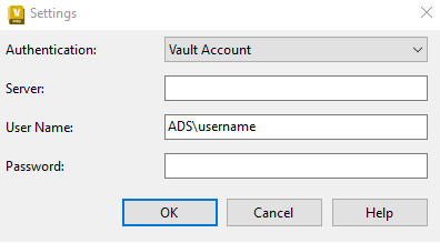

  1. On the workstation where you want jobs to be processed, go to the Windows® Start menu and select Autodesk Data Management ► Autodesk Job Processor [edition] for Vault to launch the Job Processor application.
  2. Select Administration ► Settings to display the Settings dialog.
    Note: The Settings menu is only enabled if the Job Processor is Paused.
  3. Select the appropriate Authentication method:
    • Vault Account: Requires a Vault-specific user name with a password.
      Note: If the administrator has enforced a password policy and your current password does not meet the requirements, you will receive a prompt to change your Vault account password. Login via Thick Client or contact your administrator to change the password.
    • Windows Account: Uses Windows Active Directory credentials, which are entered for you.
    • Autodesk ID: Uses Autodesk ID credentials.
  4. Specify the server from which you want the job processor to pull jobs for processing.
  5. Enter the User Name and Password of the user for this workstation. If you are using Windows Active Directory, this information is entered for you automatically.
    If you select Autodesk ID, you will need to sign-in to your Autodesk account.
    • In the Autodesk - Sign In dialog box, enter the e-mail address you used when you registered for your account.
    • Enter your password.
    • Click Sign in.
  6. Click OK.
  7. Select File > Resume to log in to the specified server.
