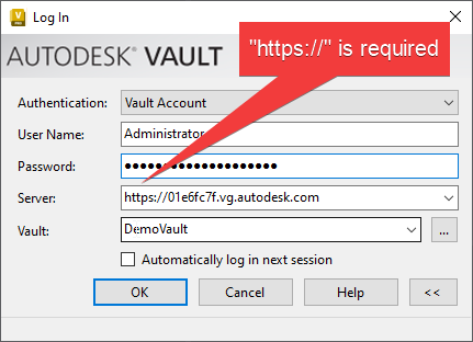

Connect to a Gateway
Logging into a gateway follows the same procedure as logging into a vault through a direct server connection. The Server field takes an HTTPS URL to the gateway (a-gateway's-host-name,-displayed-when-an-administrator-manages-a-gateway) instead of a server name. Vault clients can't connect to the gateway if https:// is omitted from the URL.
