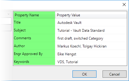

- Exercise 3 – Vault Client: Enable multi-language for User-Defined Properties
- Exercise 4 – CAD Clients: Label or localize custom property names
