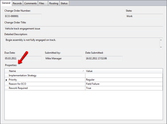

User-defined properties for change orders can be created in the Property Definitions dialog.
These properties belong to the change order itself and not its contents.
  1. Select Properties from the Behaviors tab of the Vault Settings dialog.
  2. Create a new UDP and associate it to change orders.
All change orders (new or existing) will have this property associated with it and can be edited as desired. Editing the property can be done from the Edit command of the change order or from the Edit Properties dialog.
For more about editing change order properties, see Working with Properties.

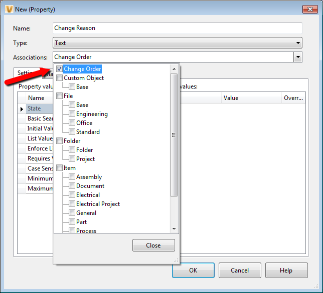

  1. Click Tools > Administration > Vault Settings.
  2. In the Vault Settings dialog box, click the Behaviors tab.
  3. Click Properties.
  4. Click New.
  5. In the New Property dialog box, enter a name for the new property.
  6. Select a property type from the Type list.
  7. Select Change Order from the Associations list.
    new property dialog
    If you want this property to be associated with other entity classes, select them from the Associations list.
