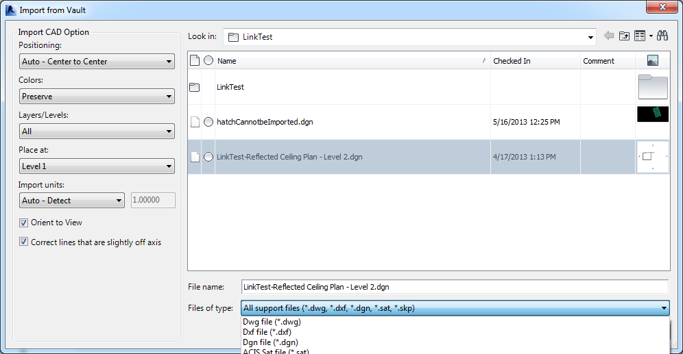

The Import from Vault Dialog
You can select a file in Vault to import into the current Revit project. You can also specify position options for the imported file on the Import from Vault dialog.

Position Options
You can select a positioning preference when you import a file into the current Revit project.
The following table describes the positioning options available for selection. Refer to Import and Link Options for CAD Formats and Revit Models for more information.
