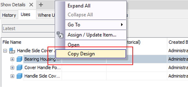

Copy Design in Inventor
You can open the Copy Design dialog from the Show Details pane in Inventor.
Right click a file in the model or a Vault browser and click Show Details.
In the Show Details dialog, select the Uses or Where Used tab.
Right click the file and select Copy Design. The Copy Design dialog opens.
In the Copy Design dialog, right-click the file to select Copy To command to copy the selected files from the main grid to a specified location. Hold the Ctrl key to select multiple files at once.
On the Select Vault Location dialog, locate the destination folder.
Select a folder and click New Folder to create a sub-folder, if needed.
Click OK.
Click Execute Copy to save the files to the selected location. Copies of the selected files are placed in the destination folder when the copy operation completes.
Right click the file and select Open command to open the copied file directly in the Inventor.
See Copy Design Interface for more information.
