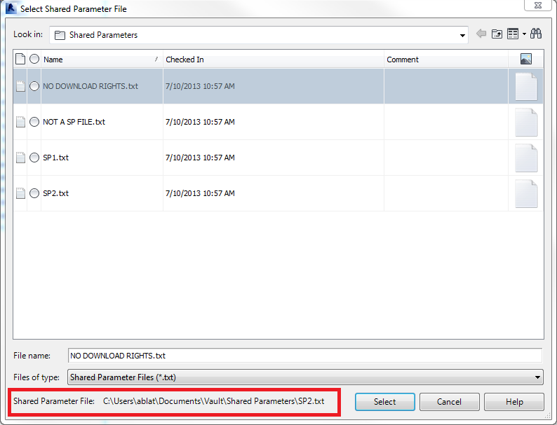

  1. Open a project file and select Shared Parameters on the Revit Vault Ribbon.
    The currently active Shared Parameters file is shown at the bottom left of the Select Shared Parameter File dialog.
  2. Select the .txt Shared Parameters file that you want to activate and slick Select.
    The latest version of the file is downloaded and set as the active Shared Parameters file.
    Note: Vault does not confirm the legitimacy of the shared parameters file, so if you select an invalid .txt file in the vault, it will still be activated as the Shared Parameters file.
