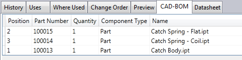

CAD-BOM Preview
The CAD-BOM preview pane displays the BOM details for the selected file, including any data gathered from outside applications.

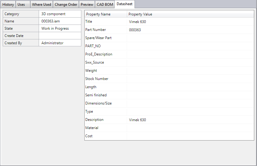

Datasheet Preview
The Datasheet preview displays standard file properties determined by your administrator. For example, the default datasheet provides at-a-glance view of pertinent file information, such as lifecycle state and category.
