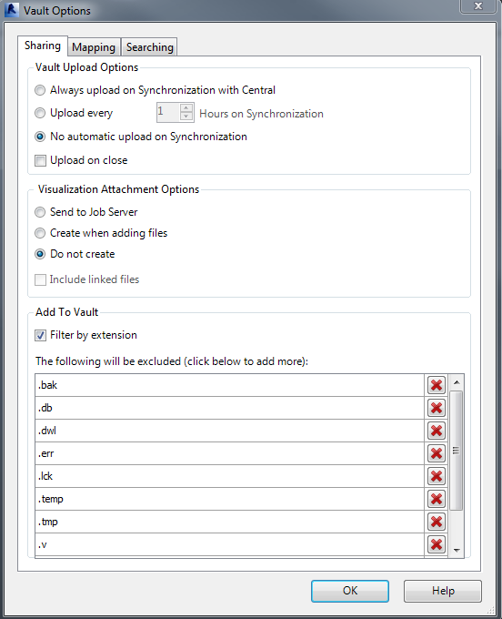

Configure your synchronization and visualization attachment options on the Sharing tab.
Vault Upload Options
Vault Upload options allow you to configure when a synchronized file is added to the vault.
Visualization Attachment Options
Visualization Attachment Options control how Visualization files are created when files are added through the Vault add-in for Revit.
Send to Job Server–When a file is added to vault, a job is queued to an active job server.
Create when adding files-Each file generates a visualization file during the add process.
Do not create–No visualization files are generated when a file is added to the vault.
Include linked files–Ensures that any selected options list above also apply to linked files.
Add to Vault
Configure which types of files cannot be added to the vault in the Add to Vault section.
If a file extension is listed, that file type cannot be added to the vault with Add File or Add Folder commands.
Clear the Filter by extension check box if you do not want to filter out files with the listed extensions. This allows you to keep the list, and turn the filter on and off as needed.
