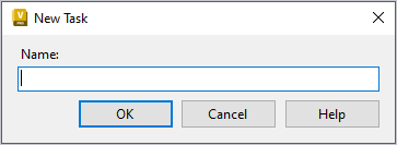

In the following example, the user is creating a new Task.
On the New <custom object> dialog, enter a name for the custom object instance.
For example, this user may want to create an instance of Tasks called Review John's Design.
Click OK.
The new custom object instance is added.
