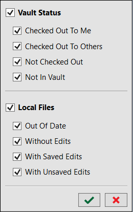

Filter the Vault Browser
You can filter the files listed in the Vault Browser by accessing the Filter menu.
- Select Checked Out to Me to list only files that are currently checked out by you.
- Select Checked Out To Others Only to list only files that are checked out by other users.
- Select Not Checked Out to list only files that have not been checked out by you or other users.
- Select Out Of Date to list only files that are out of date.
- Select Not in Vault to list only files that are not currently in the vault.
- Select Without Edits to list only files that have not been edited locally.
- Select With Saved Edits to list only files that have edited locally and saved.
- Select With Unsaved Edits to list only files that have been edited locally but have not been saved yet.
You can also select Vault Status or Local Files to select all of the options in that category.
