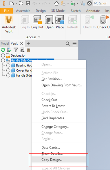

Copy Design in the Vault Browser
  1. In Inventor, right click a file in the Vault browser and click Copy Design.
    The Copy Design dialog opens.
  2. Right click the file and select the Copy To command to copy the selected files from the main grid to a specified location. Hold the Ctrl key to select multiple files at once.
  3. On the Select Vault Location dialog, locate the destination folder.
  4. Select a folder and click New Folder to create a sub-folder, if needed.
  5. Click OK.
  6. Click Execute Copy to save the files to the selected location. Copies of the selected files are placed in the destination folder when the copy operation completes.
  7. Right-click the file and select the Open command to open the copied file directly in the Inventor.
