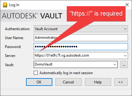

Logging into a gateway follows the same procedure as logging into a vault through a direct server connection. The Server field takes an HTTPS URL to the gateway (a gateway's hostname, displayed when an administrator manages a gateway) instead of a server name.
Note: To allow Vault Server firewalls to operate correctly, allow outbound HTTPS traffic with *.autodesk.com in the firewall. Here is a typical gateway format: https://01e6fc7f.vg.autodesk.com.
