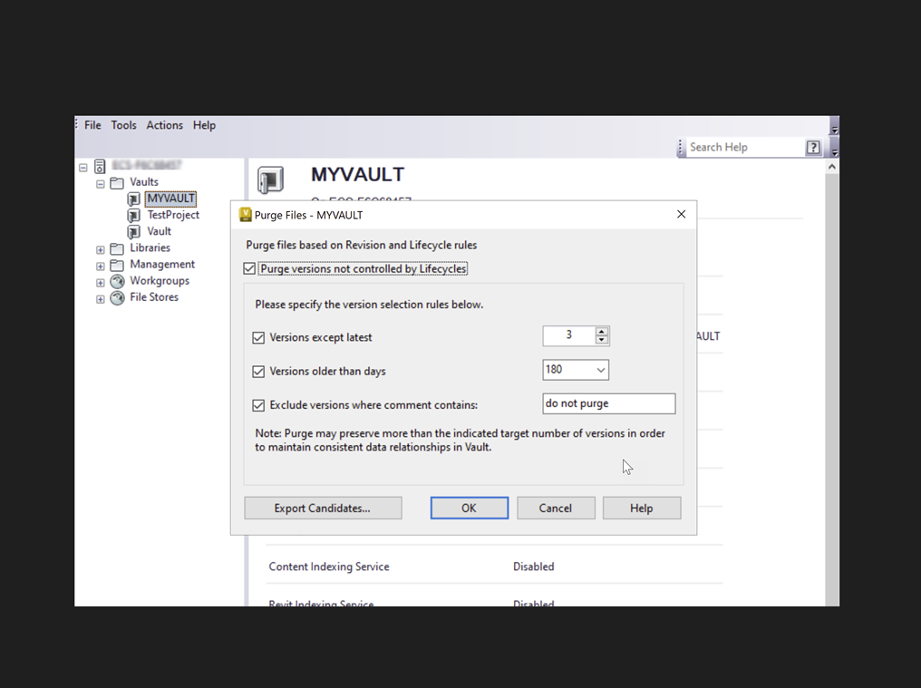

  • Right-click a vault from within the Vaults folder and select Purge Files, or
    Select the vault from the Vaults folder and click Actions > Purge Files.
    You are prompted to set the number of files you want to keep (noting you can never purge the latest), how old the files should be, or, based on comments, what files you want to keep. Combining these settings results in a list of file versions that are eligible to be purged.
  • In the Purge Files dialog, turn on the check box next to each of the selection rules to determine the data to be purged:
    Versions except latest Specify how many file versions to leave in the vault.
    Versions older than days Specify how old the files to purge should be.
    Exclude versions where comment contains Enter a text string contained within the Comments field of the files in the vault. Any files containing this string will be excluded from the purge process.
    This option is only available if any of the above checkboxes are selected.
  • Click Export Candidates to generate a pre-report (.csv file) that shows the list of purge candidates.
    Note: The pre-report includes all file versions that can be purged. However, some candidate file versions can't be purged if some non-purgeable parent files use them.
  • Click OK to initiate the purge.
Every version of every file within the vault will be analyzed and purged using these settings. However, file versions that are part of file or item revisions are not purged, even if they match all these settings.
Note: When working with the vault like this, performing a backup before completing the purge operation is highly recommended.
Here, in this example, we have a vault named MYVAULT. We specify to keep all the versions except the latest three, or we could even say the latest five. We can also purge it based on time, so we specify to purge everything half a year old. In addition, we can exclude the version from being purged with a particular comment, for instance, "do not purge."

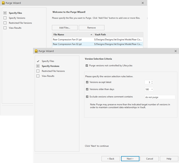

To purge files from the main Vault Client:
  1. Select a file or files, and then select Purge from the Edit menu, or
    Right-click a file, and then select Purge.
  2. The Purge Wizard lists the file or files that were selected from the main pane. Click Add Files to include other files from the vault.
    To exclude a file from being purged, select it from the list and then click Remove.
    The parents and children of a selected file can be included in the purge. Right-click on a file in the list and select Add Parents or Add Children to include the related files.
  3. Click Next.
  4. Click the Purge versions not controlled by Lifecycles check box to purge versions not defined by revision and lifecycle rules. This action enables the Specify the version selection criteria box.
  5. In the Specify the version selection criteria box, turn on the check box next to each of the selection rules to determine the data to be purged:
  6. Click Next.
  7. If there are any restrictions on the versions to be purged, the restricted versions and the reason for the restrictions are listed.
  8. Click Finish to purge those versions that are not restricted, or click Cancel to exit the Purge Wizard.

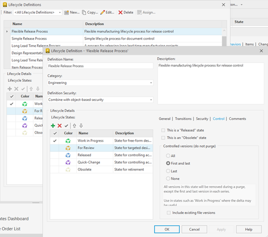

Purging in case of lifecycle states
When you set up your lifecycle states, there is a Control tab where you can set what file versions should be kept: all versions in that state, the first and last versions, the last version in that state, or none. Configure your purge preferences for files assigned to a lifecycle definition to help manage Vault file retention. Purging Vault will always purge first based on lifecycle control settings.
To configure the control preferences:
  1. Click Tools > Administration > Vault Settings.
  2. In the Vault Settings dialog, click the Behaviors tab > Lifecycles.
  3. In the Lifecycle Definition dialog, select the name of the lifecycle definition, and then click Edit.
  4. From the Lifecycle States grid, select the state you want to edit and click the Control tab.
  5. Select one of the following options:
    • All - No versions in this state are removed when a purge is performed. This option is recommended for states where not many versions are created or where each version is critical.
    • First and Last - All versions in this state are removed during a purge, except each series' first and last version. Use this option for states where the changes between the first and last files are helpful.
    • Last - All versions in this state are removed during a purge, except the last version in each series. This option is recommended for states where a record that the file was in the state is essential.
    • None - No version in this state will be retained after the purge, except the tip version of a revision and the versions consumed by a parent file.
    Note: The basic purging rules are also applied to the selected option
    Important: No record of the file in this state will exist after the purge.
  6. Turn on the Include existing files versions check box to apply purge restrictions for lifecycle states for existing versions of files.
    Note: If this box is not checked, the purge version control settings apply only to new file versions.
When you now purge your vault, the list of eligible files and items is built from the lifecycle control setting for that version.
Here is an example that highlights what files will be purged in a lifecycle scheme scenario. Considering there are no dependencies, the following are the purge settings:
  • Released: Last
  • For Review: First and last
  • Work in Progress: None
We have different versions at different revisions and lifecycle states.
V1 V2 V3 V4 V5 V6 V7 V8 V9 V10
Rev A Rev A Rev A Rev A Rev B Rev B Rev B Rev C Rev C Rev C
Work in Progress Work in Progress For Review Released Work in Progress Work in Progress Released Work in Progress Work in Progress Work in Progress
Now, upon purging, all the versions except V3, V4, V7, and V10 are purged as per the criteria and the following versions remain after purging. It doesn't matter if we have selected to keep the last three or the last five under the selection criteria.
V3 V4 V7 V10
Rev A Rev A Rev B Rev C
For Review Released Released Work in Progress
